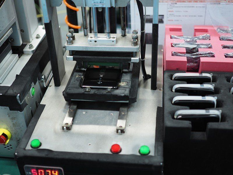

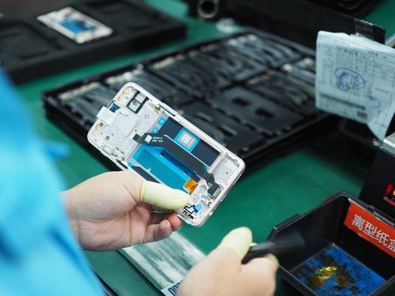

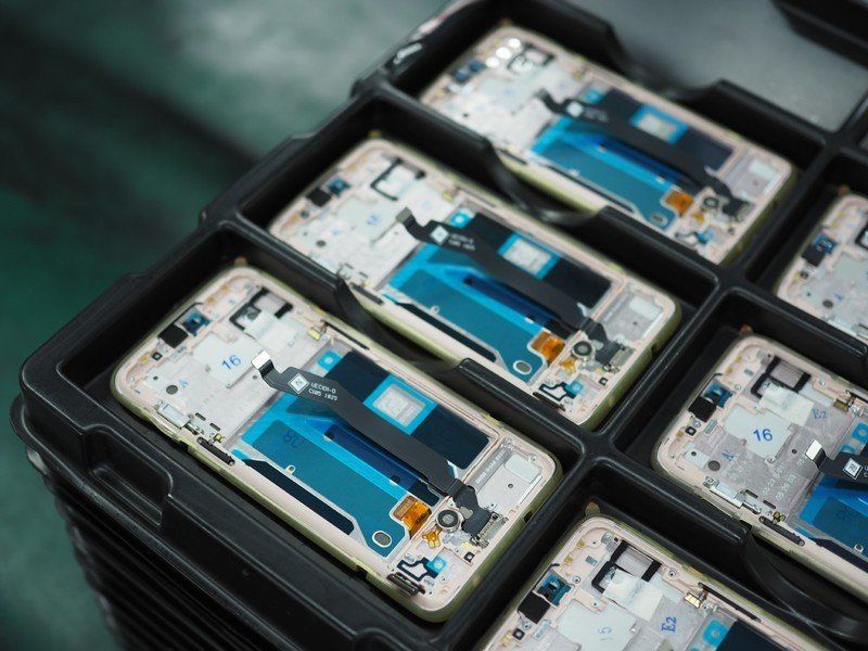

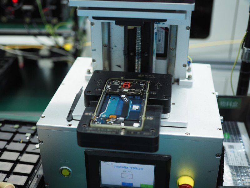

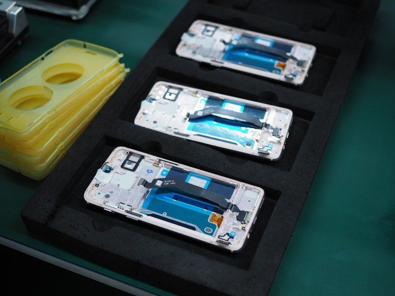

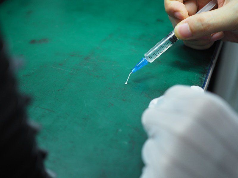

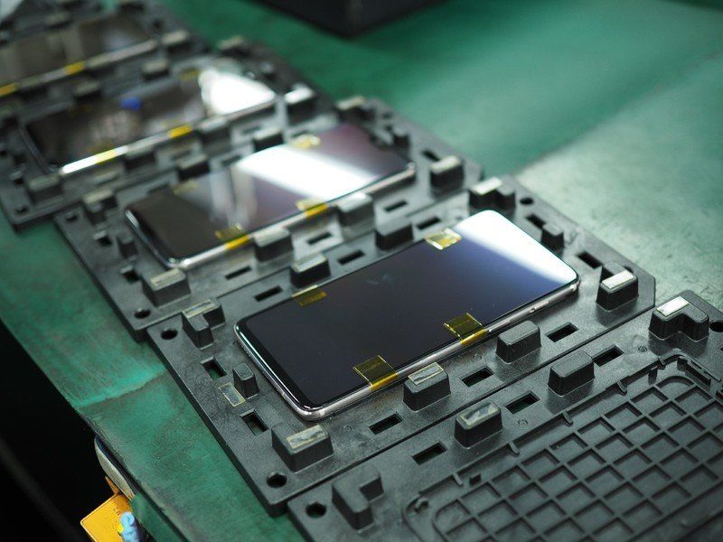

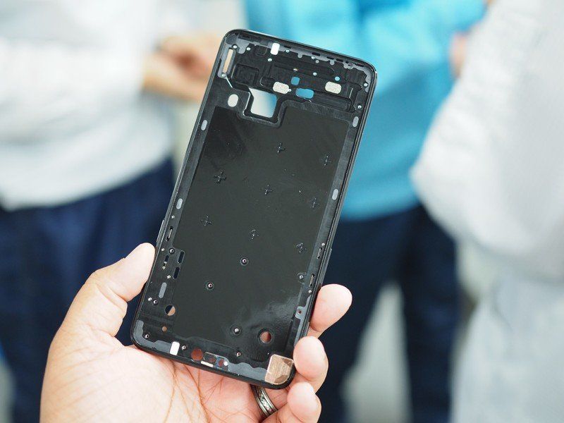

The assembly process starts off with the mid-frame. The mid-frame comes from a manufacturing facility that's located a few miles away, and the first bay in the assembly line houses a machine that drills a series of holes into the mid-frame. Then the panel is affixed to the front using adhesive, and the phone is then sealed in a case and tightened so the glue affixes evenly.

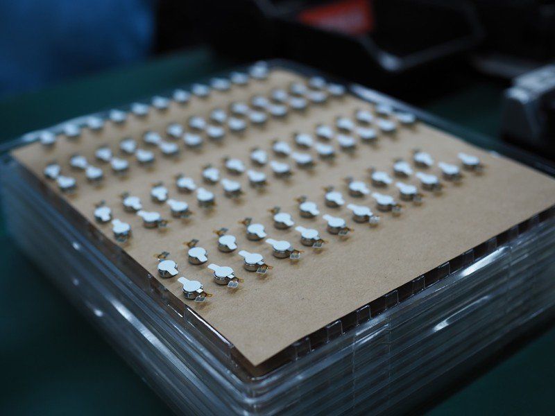

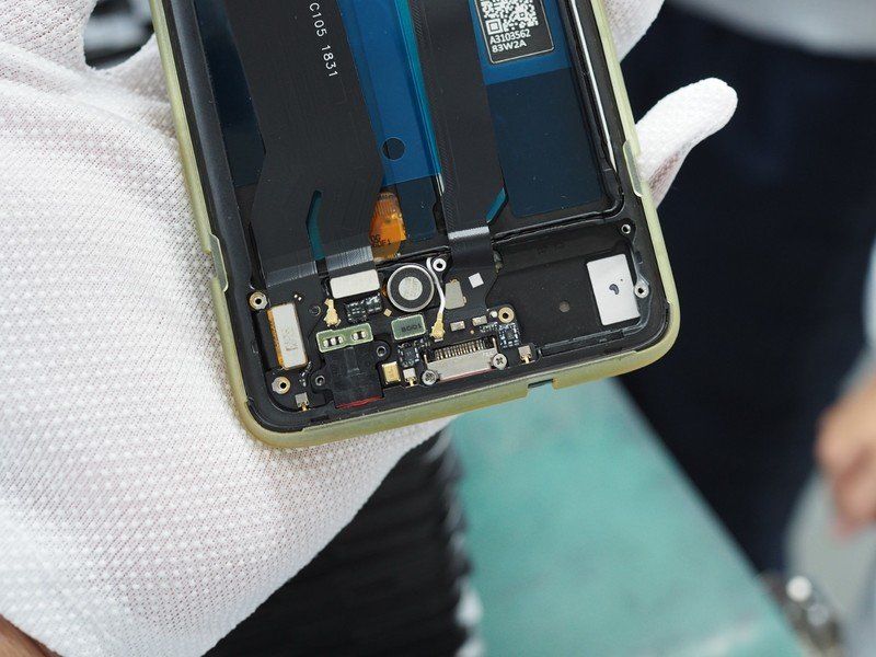

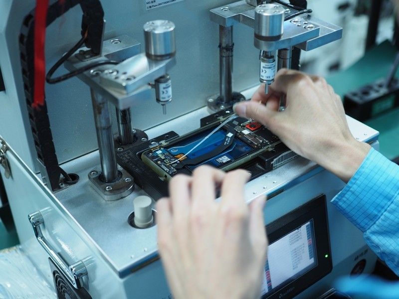

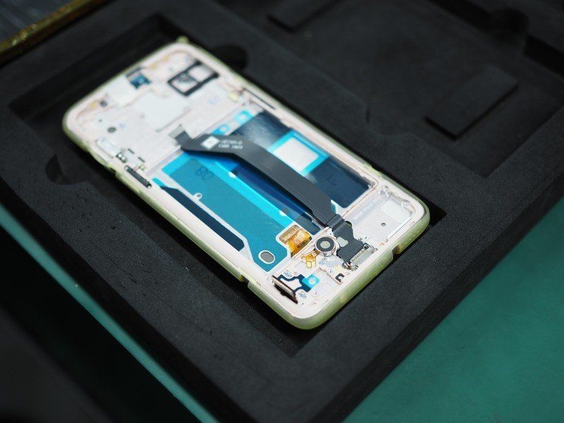

Once the panel is affixed firmly, it's time to hook up the connectors for the USB-C charging port at the back. Then the haptic motor is connected to the back of the device, to the left of the USB-C port.

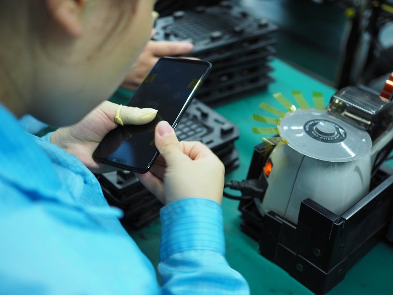

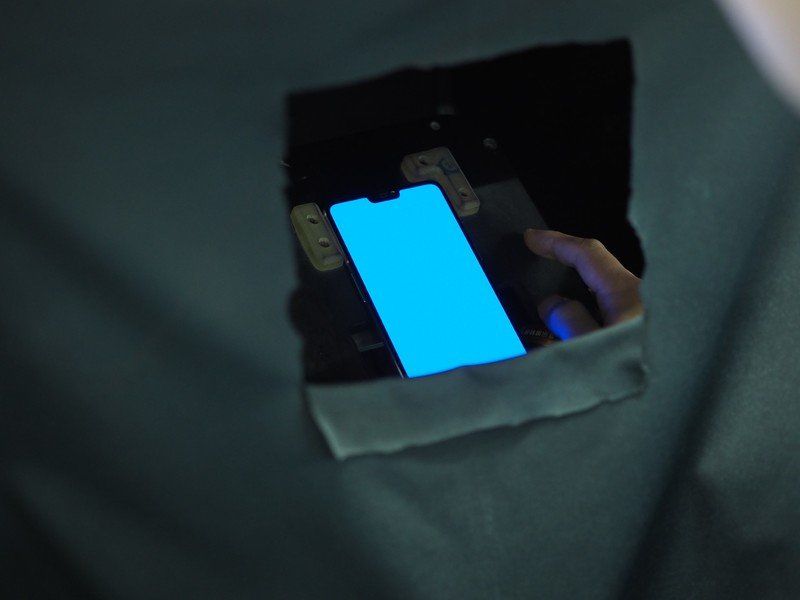

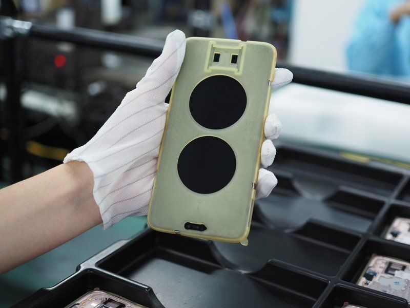

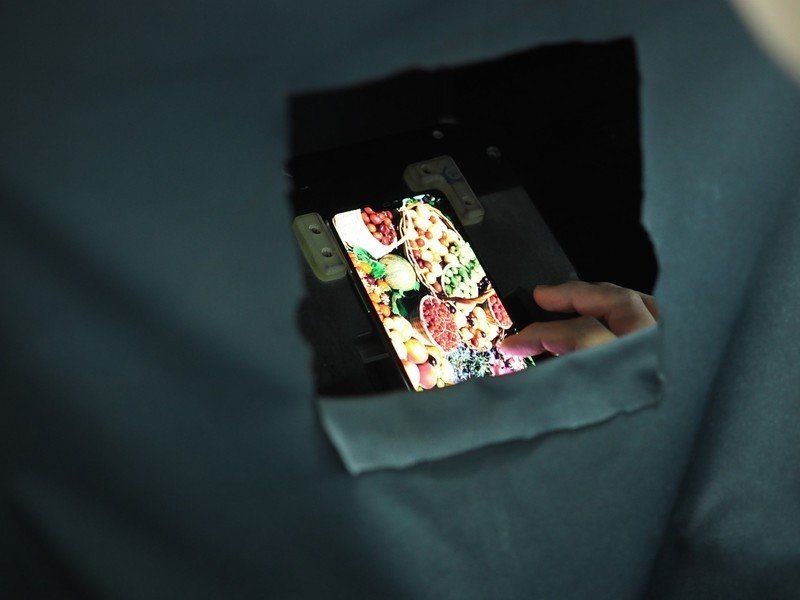

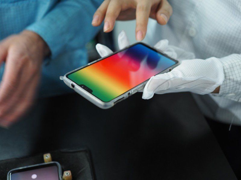

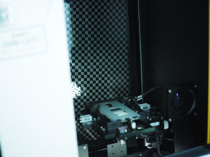

Next up is a machine that checks the display for any issues. As the mainboard isn't hooked up to the phone yet, it is connected to an external machine that cycles the panel through a gamut of colors and scenes to make sure the panel doesn't have any defects. After the display tests are finished, the device is placed in a case that covers a sizeable portion of the screen to prevent it from taking any damage while on the assembly floor.

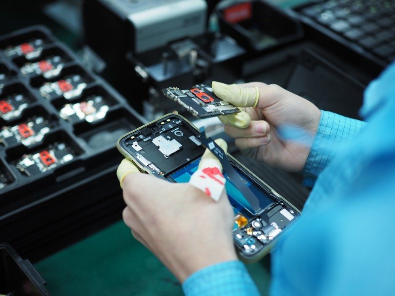

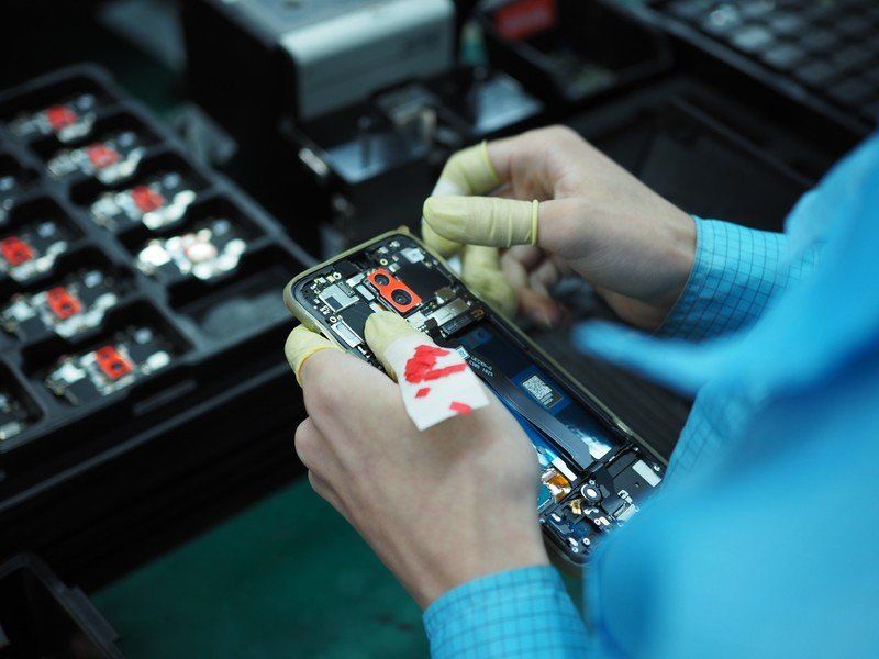

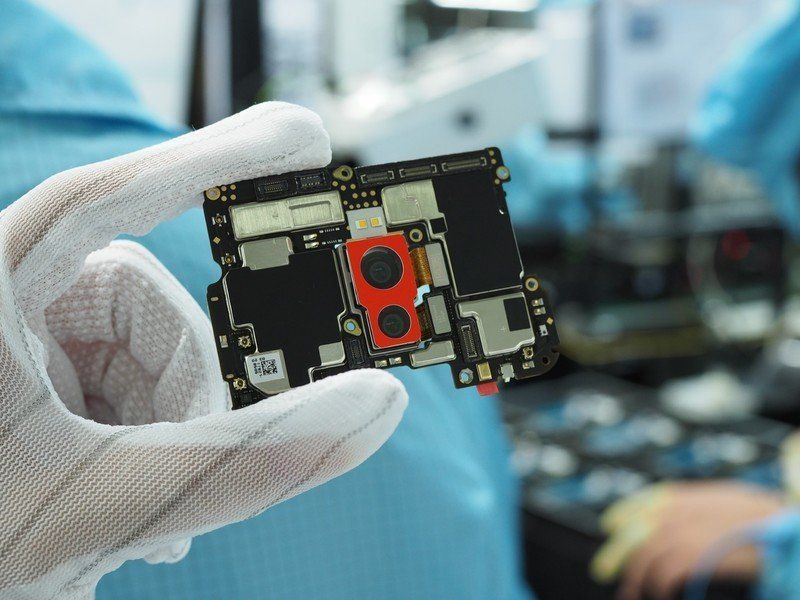

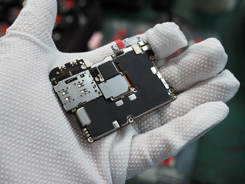

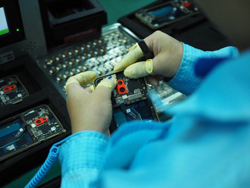

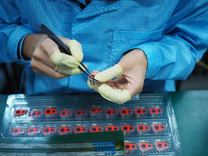

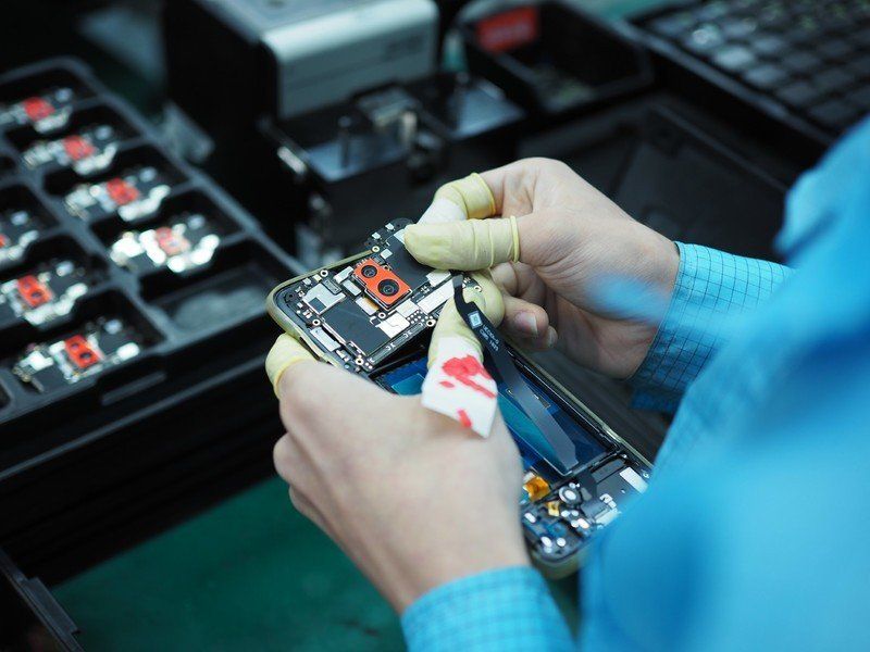

Once that's done, it's time to connect the camera to the mainboard. The camera sensor is removed from its packaging and slotted into the mainboard. The mainboard also contains the Snapdragon 845 chipset, the UFS 2.1 flash memory module, as well as the LPDDR4X RAM along with the Wi-Fi and baseband modems. Essentially, this is the heart of the phone.
Once the camera module is attached, the mainboard is affixed to the phone, and then the front camera assembly is mounted at the top.

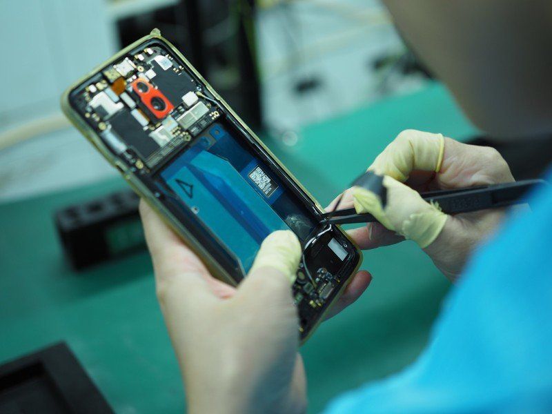

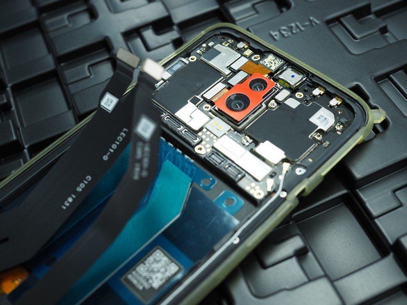

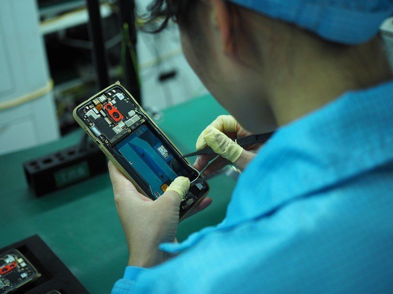

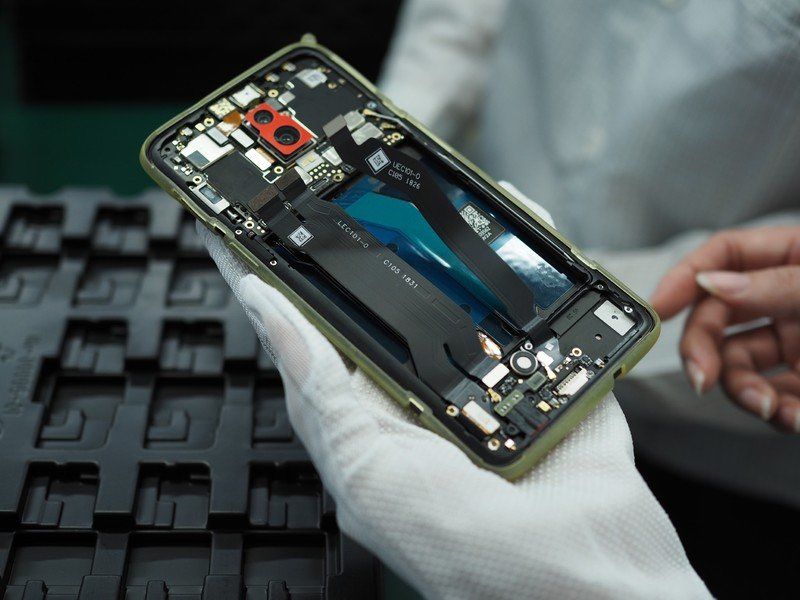

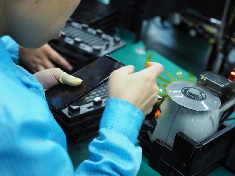

After that, a series of FPC connectors for the screen, 3.5mm jack, and the USB-C port are hooked up to the mainboard.

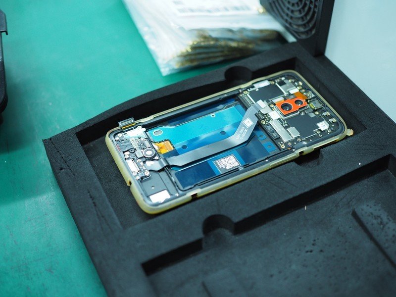

Interestingly, there's a water damage indicator that's located at the bottom. It's essentially a tiny square of paper that is placed on one of the data cables, and it'll turn pink as soon as it comes into contact with any water.

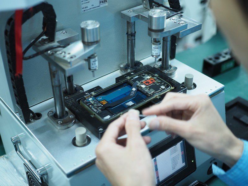

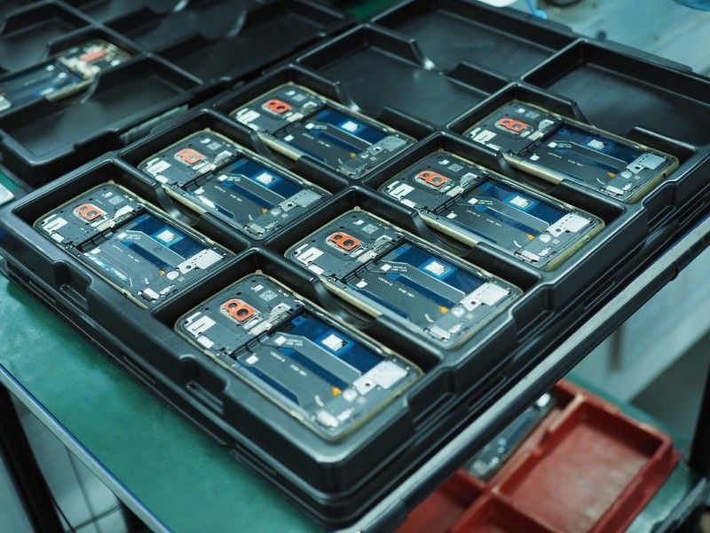

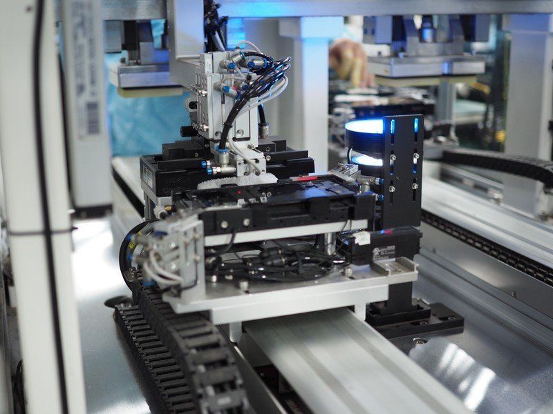

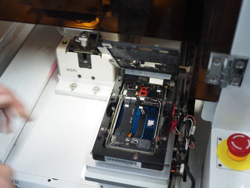

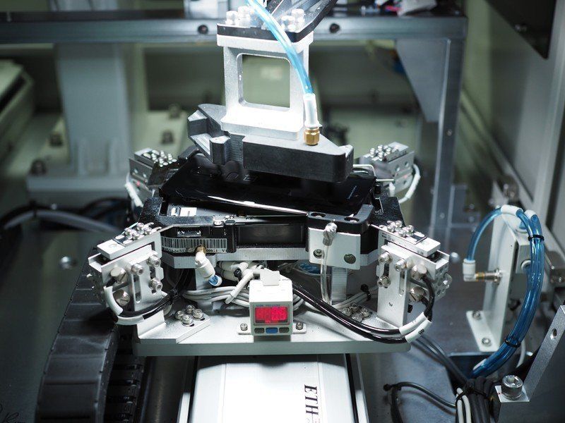

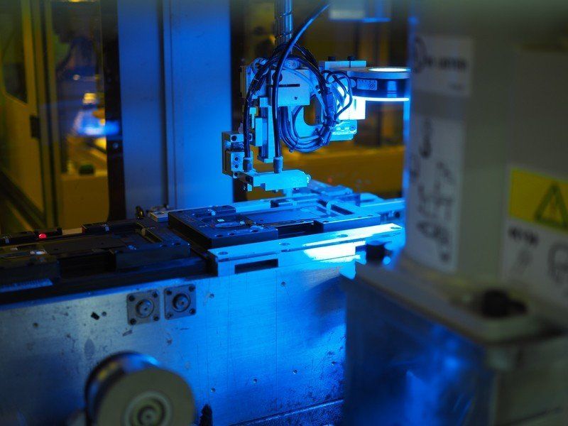

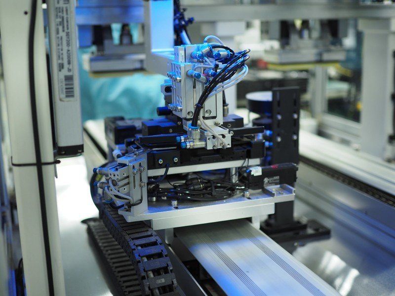

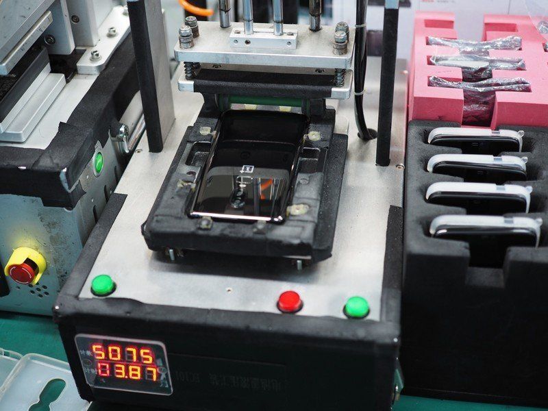

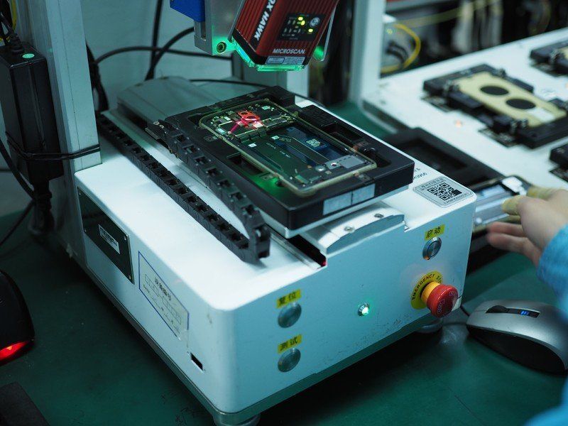

After this, a machine scans the screws and the overall assembly to make sure the tolerances are in order and that there are no defects. Once the parts are assembled, the plastic antenna frame is added to the top section, and a similar housing over the bottom section covering the USB-C port and the 3.5mm jack.

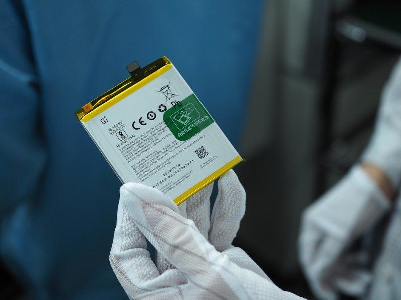

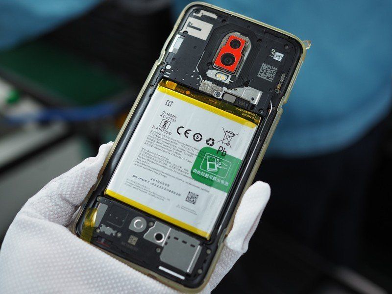

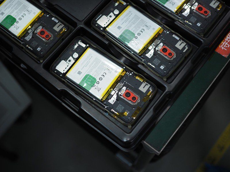

That marks the end of the assembly, and now it's time to slot in the battery. This is fairly straightforward, and the 3300mAh battery has a green pull tab that makes it easy to remove (even though it isn't easily accessible as you'll have to remove the glass back to get to it).

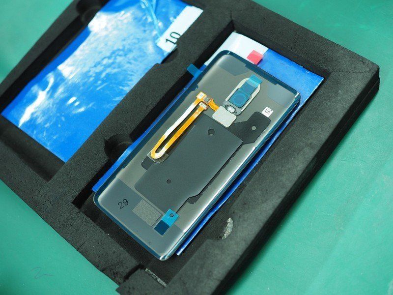

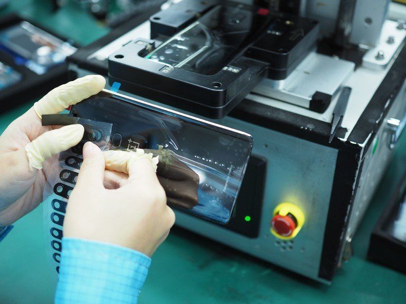

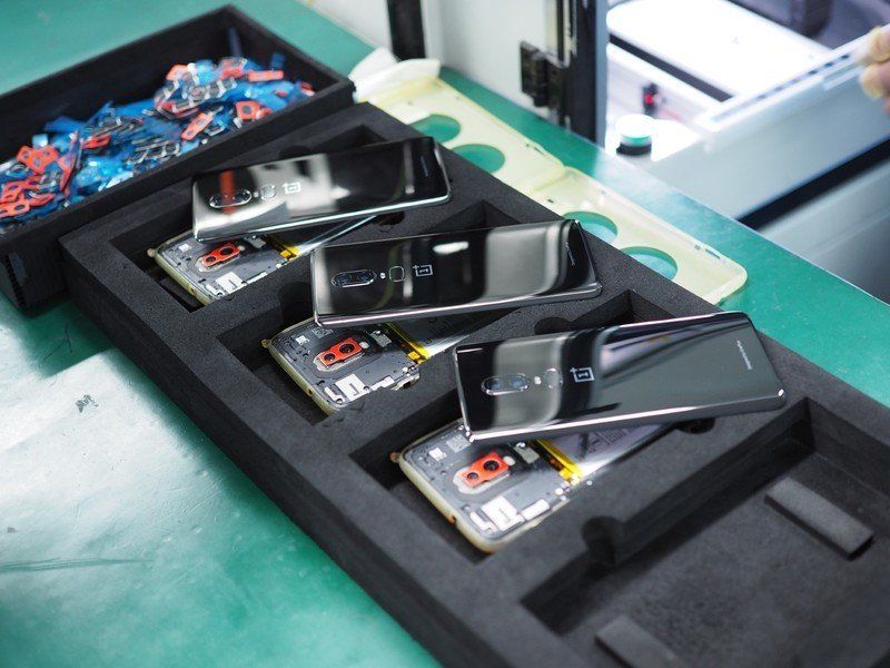

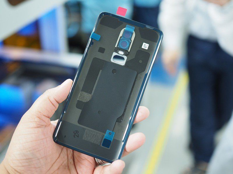

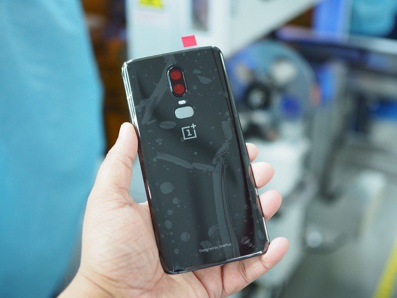

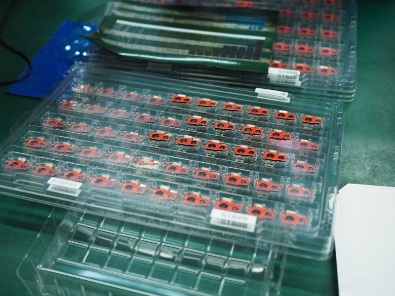

The glass itself is manufactured at a third-party supplier, and the first step is to affix the fingerprint sensor cable to the back. That's the long orange cable you see in the image above. Once the cable for the fingerprint sensor is affixed, it's time to attach the lens cover over the camera housing.

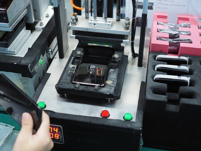

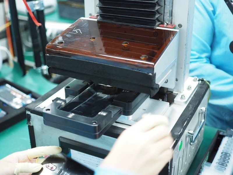

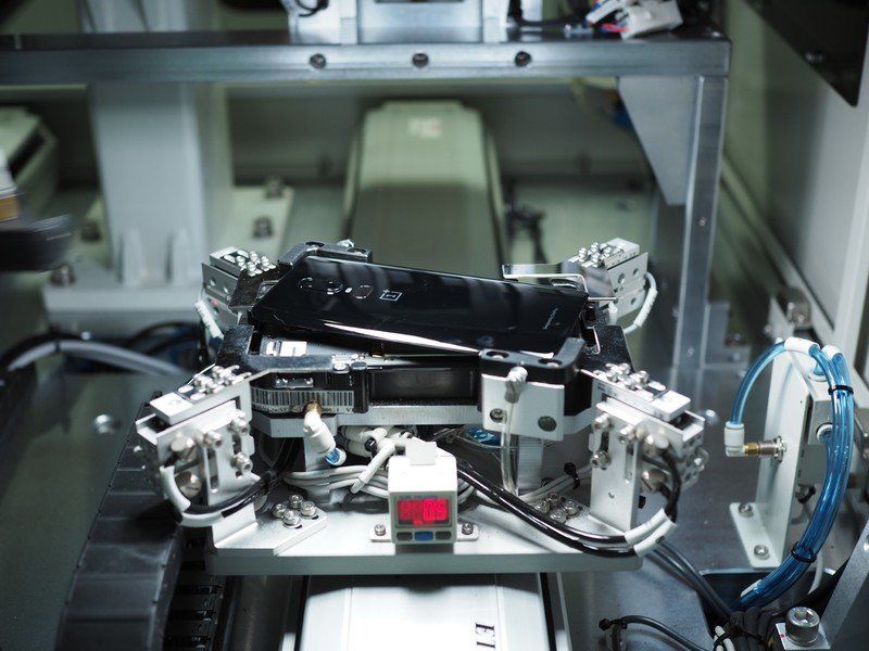

Now comes the interesting part — attaching the glass back to the phone. A machine stamps the glass back into place, and another machine rolls the sides so the adhesive is firmly affixed.

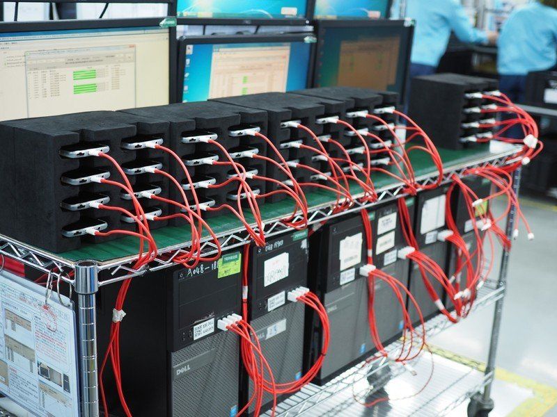

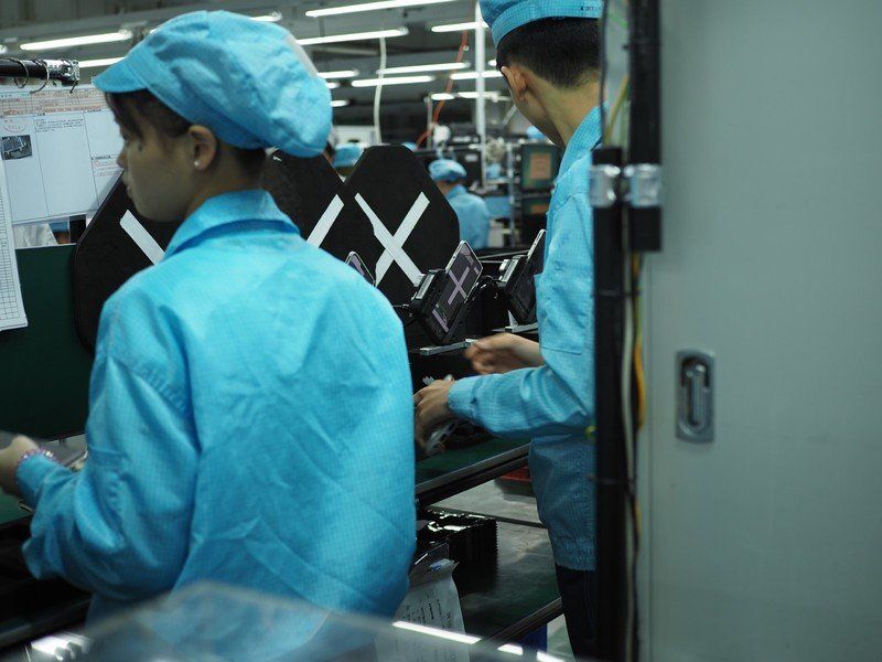

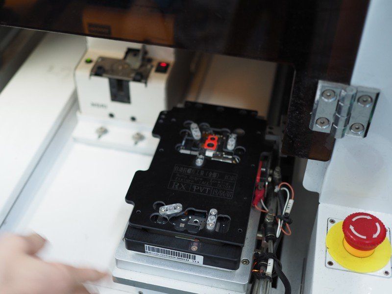

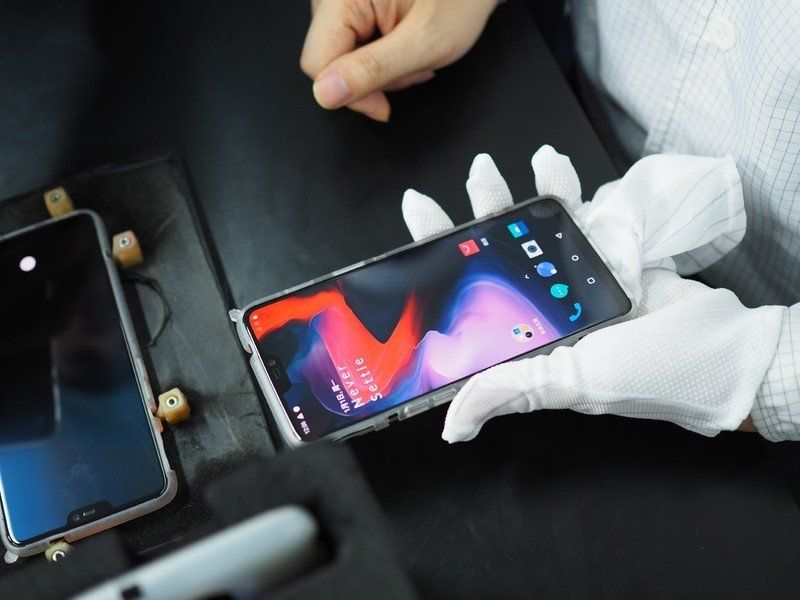

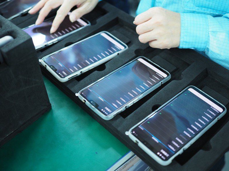

Once the final assembly is done, it's time for testing the phone. A battery of tests are conducted on the assembly floor itself — including battery charging tests, display and color accuracy tests, as well as vibration and camera sensor focusing tests.

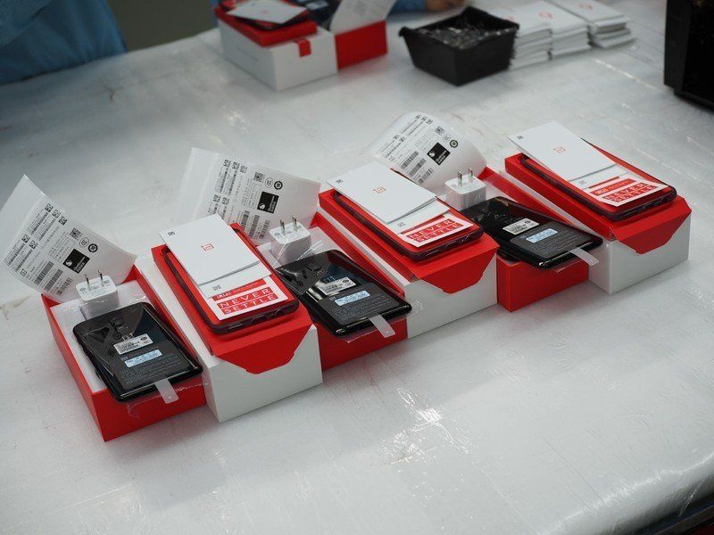

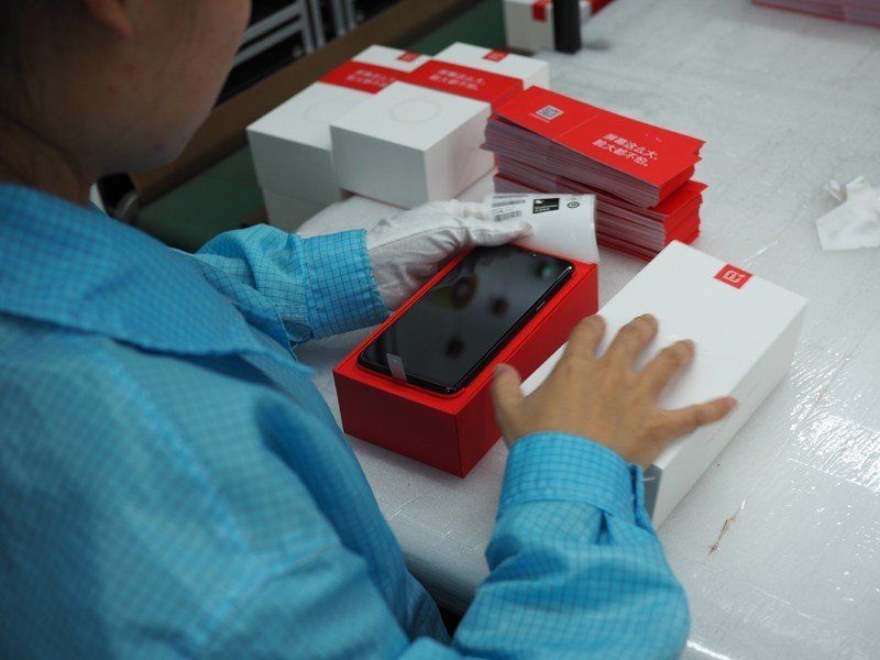

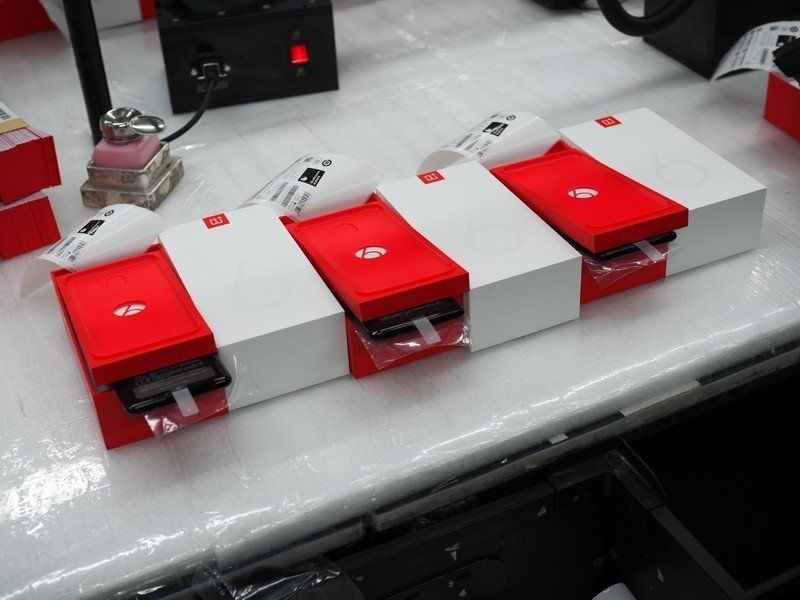

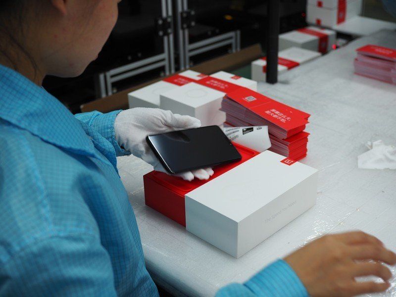

Once the tests are done, a layer of film is fixed over the entire surface of the phone, and then it's off to packaging. I always assumed the labels on the back of the box were done by a robot and not by hand, so it was surprising to find that this isn't the case.
Once the packaging is done, the OnePlus 6 is ready to be put into containers and sent off to various destinations around the globe. The assembly line I went to primarily caters to the Chinese market, as you can make out from the product packaging.
